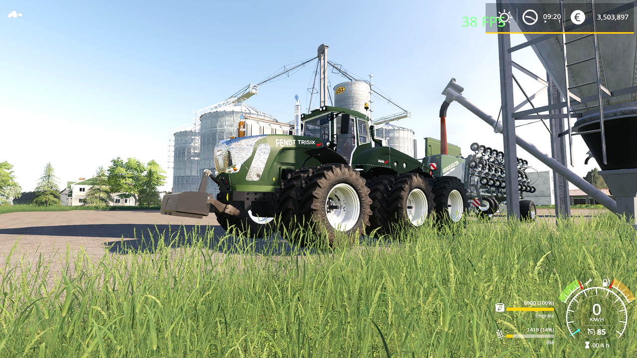

We are nearly to release the V2 of the Fendt Trisix
on V1, real dirt color was working fine. But for an unknown reason, it is not the case anymore. We have two wheels without dirt. All of the tyres (6 or 12... depending on the wheel config) has tire, innerRim outerRim, and hub.
I tried to add the lines in the vehicule XML : simple mod and disable nbr of wheels limit. With no succes.
I have no clue, what I should check, as we did not change anything on V2 that can causes this issue with real dirt color.
Have I missed something ? It is quite frustrating as I lot of people are using this (great) mod and I really like to release it. it is the only issue whe have on the Trisix.
I someone could help, It would be very appreciated.
Thanks for reading my post.

Post by ricobab » Fri May 03, 2019 5:14 am
Thank you very much for your quick reply. I just sent you a pm with a link to the Trisix V2.
If you have any question, do not hesitate to contact me.
Here real dirt color is enabled : no dirt on the front/right wheels and rear/left wheels
